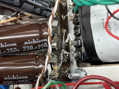

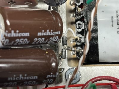

Could you shoot a picture showing how the UF4007 diodes are installed in your kit?
Offline Bad@DIY
    • Posts: 9
Reply #4 on: September 27, 2023, 05:48:28 PM
here they are.  tough to get a good angle on them.
    • Posts: 19751
Reply #5 on: September 27, 2023, 07:09:30 PM
The problematic resistances you're describing would likely blow the fuse and cause things to get hot.  There's a 680 ohm resistor that goes across from terminal 5 to terminal 11, then from there the primary of the output transformer connects and feeds over to terminal 3.  You are seeing the difference in resistance between 3 and 11 that looks mostly OK, but terminal 11 being 93 ohms means that there's something wrong around that terminal most likely.  I would carefully inspect for debris that would allow for conduction that could throw off the resistance values like this.  If there isn't any debris or an unclipped wire lead causing this, I can give you some guidance on pulling a thing or two apart to better isolate where the problem may be.

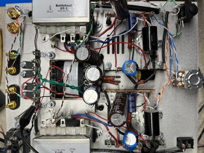

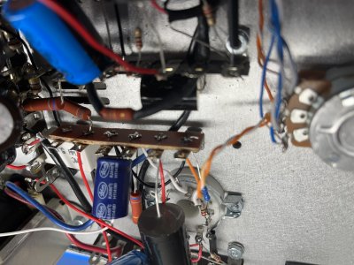

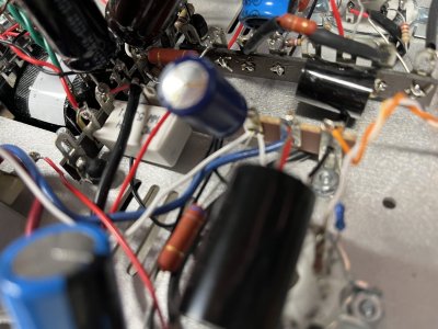

I would start by taking the 1000uF cap out of the problematic side, then recheck the resistances and let us know if they change.  Maybe also post some photos of the area with that cap out.

You took the 100uF cap off, not the 1000uF cap.  You can leave the 100uF cap off for now if you like, but take off the 1000uF/35V cap and see if that makes a difference.
