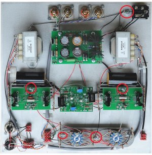

    • Posts: 20299
Reply #7 on: October 07, 2023, 08:50:55 AM
What's the DC resistance between the "E" terminal on the IEC power entry module and the bare metal of the plate holding the attenuator switches up front?

Getting 37.4 kohm
    • Posts: 20299
Reply #9 on: October 07, 2023, 09:32:24 AM
The paint on the bottom side of the plate is causing issues.   I've circled some points that need to be scraped on the bottom side of the plate to establish proper earthing.  I would scrape a few of the holes around the standoffs for the front attenuator plate just to be extra sure that grabs earth nicely.

Reply #10 on: October 07, 2023, 09:44:43 AM
Thanks for that, though I think that shouldn't be an issue anymore. I sanded off those spots as well as the ground lug at the headphone jack and the lug by the center tube socket, so they should all have a good connection to the plate.

Reply #11 on: October 07, 2023, 09:58:02 AM
The E terminal of the IEC power entry module and the plate that the attenuator switches mount to should show continuity.  Since they don't, you'll have to track down where this interruption has happened and correct it.

    • Posts: 20299
Reply #14 on: October 07, 2023, 02:32:21 PM
Do the rest of the locations circled show continuity to E?  I had forgotten about the diodes, that will throw off that reading.
My suspicion is that there's an earth reference that's just missing and resolving that may fix your hum.
