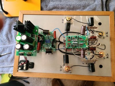

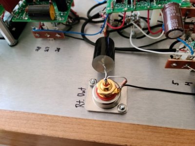

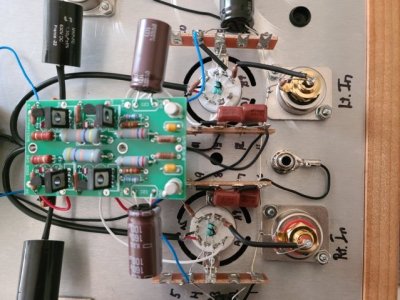

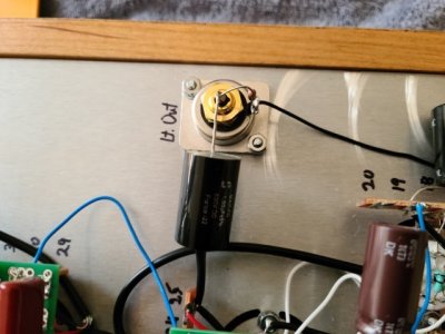

I'm praying that I didn't cook several resistors when soldering, measuring open circuit at input/output center pins.

Can you post some build photos? What meter are you using?
