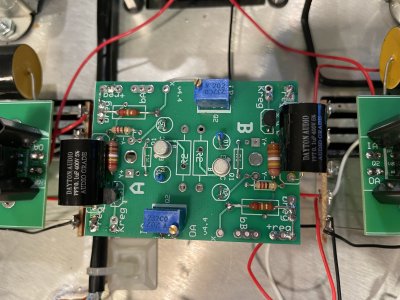

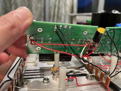

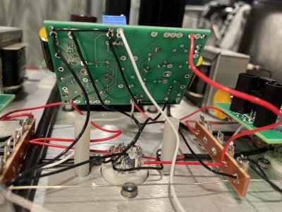

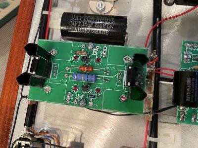

I'll attach some photos and apologies in advance, I installed the LEDs right way up after quadruple checking polarity so I'm 99% sure they're correct, subtracting a 10% variance for building it till 1am so I'm 90% sure. Also full disclosure, one resistor on the volume selector is unsoldered, I'll sort that on the next solder run and did press down on it to make sure it was connected when I rechecked the resistances.

Q1 on the B side of your center PC board may have a solder bridge on it.  Since you have already turned it on, you'll just have to do that again and report on the voltages.
With LEDs that aren't lit, it is extremely helpful to install the LEDs as we show in the manual.  This allows us to be able to look at your PC board and tell that all the LEDs are installed in the correct direction, and the bit of added length on the leads of the parts helps them not absorb as much heat during soldering.  If the issues persist, you may end up needing to remove all the LEDs on the PC board on the side that isn't working and replace them with inverted LEDs just to rule that out, as it's such a common mistake.  It is also somewhat possible that your meter may light them up in the diode check setting, though that may only work for half of them.
