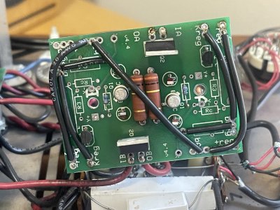

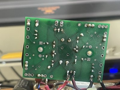

charleskeough
Jr. Member
18
Re: Quiet and muddy sound
Reply #12 on:
February 06, 2024, 07:55:22 AM
Pictures are attached. Let me know if you need other camera angles. I desoldered a couple of wires to be able to get under the board to run the check on the Q1 transistors and the board is still in that state. Let me know if anything looks like it could be the culprit. Thank you for the help
Paul Birkeland
Global Moderator
20282
Reply #13 on:
February 06, 2024, 08:53:45 AM
That looks a lot like either lead free solder or just not enough heat on those joints (maybe both). This is especially problematic for the center legs of the MJE5731A transistors which connect to the metal tab and sink a lot of heat. I would reheat all the joints on that board other than the LEDs and add some leaded solder if you've been using lead free solder. When you heat up the joint, let the iron stay on the joint for 3-5 seconds after the solder flows out.
