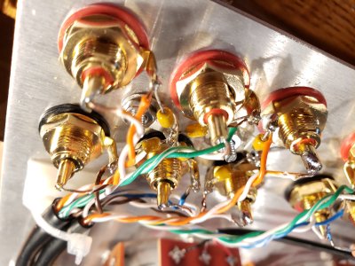

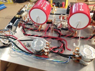

Hello. I just want to check if my resistances are OK. It is wired for 230v. I made some mods. I use 220uf 16v Nichicon FG instead of the 150uf cap. Also switched out resistors for Takman/Mills/Shinkoh and replaced stock caps with Clarity Cap 2.2uf 400Vdc
What is the reason for higher ohm at terminals where it should be 0?
2: 30Ω
3: 50Ω
4: 640Ω
12: 30Ω
13: 52Ω
14: 640Ω
A5: 250Ω
A6: 38Ω
B5: 104KΩ
B6: 104KΩ
22: 52Ω
23: 43Ω
25: 52Ω
26: 230Ω
31: 420Ω
32: 56Ω
35: 38Ω

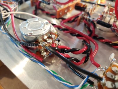

Reply #1 on: February 01, 2024, 01:47:31 PM

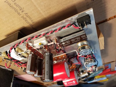

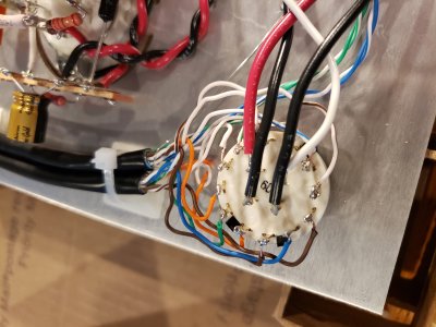

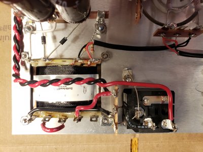

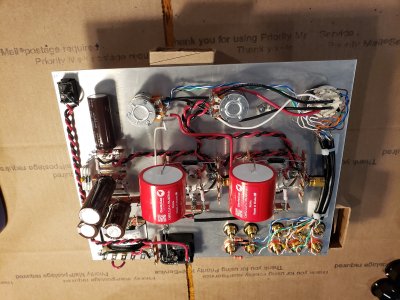

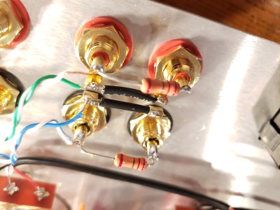

More pics

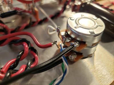

Offline Jimb0
    • Posts: 304
Reply #2 on: February 01, 2024, 01:51:32 PM
Also is it ok to have terminals 21U and 23U bent like this? I missed the "this capacitor will lay flat on the chassis" part and clipped them before giving it enough lead to sit on the chassis
Also I apologize some pics are coming out backwards for some reason

    • Posts: 20292
Reply #3 on: February 01, 2024, 02:12:18 PM
What value of resistors do you have installed between 1 and 6? and 11 and 16?  It looks like 22 ohms.  These should be 10K/5W.  Whatever you do, don't turn this on with this error.  I'm not sure what will burn up first, hopefully just the fuse, but things will be a bit unhappy in this configuration.
    • Posts: 20292
Reply #4 on: February 01, 2024, 02:14:44 PM
That's not particularly bothersome.  If you're shipping this overseas, you'll want to glue that cap down, glue the other power supply caps together so they can't move, and definitely provide some kind of external support to those Clarity Caps!

    • Posts: 20292
Reply #8 on: February 01, 2024, 03:18:43 PM
PB, is everything good to go with the preamp? What is the reason for the higher readings where it is suppose to be at 0 ohms?
I'm most concerned about the 22 ohm plate loading resistors...
Where are you connecting your black meter probe to measure the resistances?

Offline Jimb0
    • Posts: 304
Reply #9 on: February 01, 2024, 03:39:58 PM
Terminal 23
My apologies PB. I installed the wrong part. I mixed up the 22ohm 5W resistor with the 10K 5W when I was buying the parts.  :-[

    • Posts: 20292
Reply #11 on: February 01, 2024, 03:50:23 PM
Terminal 23
23 connects to 12 with a black wire.  12 connects to 2 with a black wire.  Having 30 ohms here means that there's possibly a soldering issue between 23 and 12, or you might want to double check what resistance reading you see if you touch your probes together, as that could be throwing things off a little.
Offline Jimb0
    • Posts: 304
Reply #12 on: February 01, 2024, 05:05:28 PM
Thank you very much for the help and important info PB. I will switch the cathode bias resistor back to the original one. You were right about the probes, I was using an alligator extension clip that increased the readings to 30 ohms. All the readings are back to 0 now.
