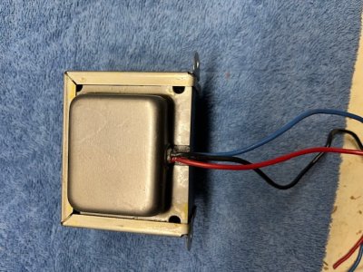

The insulation on the wires on one of my plate chokes is cracked and split were it exits the plate choke. Is this a problem? Doesn't look good to me. I will try to attach a photo.

There is high voltage going through the choke. I wouldn't feel comfortable using that. You contact replacement parts at bottlehead.

We can certainly replace that. As an alternative, you can purchase this product and apply a dab of this compound to the cracked area and it will be an acceptable repair:
https://www.amazon.com/AmplifiedParts-Corona-Dope-2-oz/dp/B00E1QZ2SY/ref=sr_1_2?crid=3MKVPW4ED3IIW&keywords=corona+dope&qid=1707925518&sprefix=corona+dope%2Caps%2C148&sr=8-2
