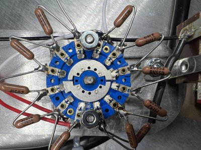

Hi Paul, thanks for your reply.
The level balance sounds fine above -18.
I've attached a picture of the attenuator, I noticed that the switch wasn't reaching some of the connector clips but I have rectified that now.
Does the soldering look okay?
I've just noticed a hairline crack on the top of the blue area which is a bit concerning!

Reply #3 on: February 27, 2024, 04:37:45 AM
That switch needs to be removed and replaced.  For whatever reason, you have some bent contacts on one side that are causing your problem.  It looks like something smooshed into them and mangled them a bit.

Reply #4 on: February 27, 2024, 05:47:30 AM
Thanks Paul, I'll order some new parts.
