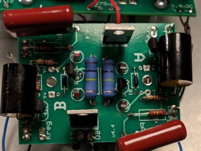

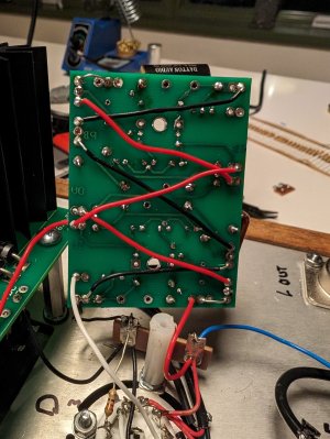

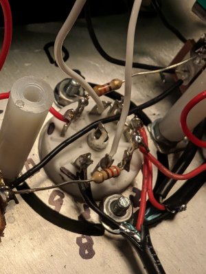

Here are the images of the board/Au7 socket in question.

Just completed my Eros 2 build and ran through the resistance and voltage checks. Everything within spec except for 1A & 1B reading 100v.
Is this IA and IB on the regulator board over the D socket or on the PC board up front?
OA/B 220v
AKREG 7.09
BKREG 7.06
A/B bregs 0
 I accidentally installed the 220 ohm instead of the 220k ohm and powered up as recommended before I spotted the error and replaced w/ the correct resistor.
I'm super confused here.  The manual says to test the board above the D socket and not to proceed if those voltage checks don't pass, but you say you've completed the build so they must have passed at some point?
On the D socket PC board, OA/OB each connect to the breg pads with wire and allow the regulator to work to pull down the incoming B+ to 220V regulated.  You have an appropriate set of Kreg voltages and correct OA/OB voltages, so my suspicion would be that you should redo your Breg measurements.
