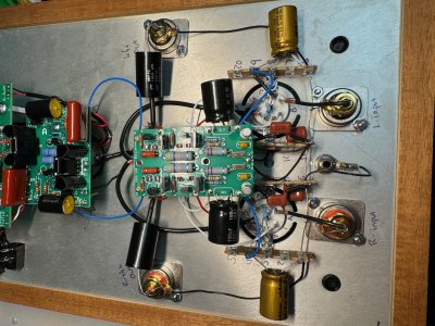

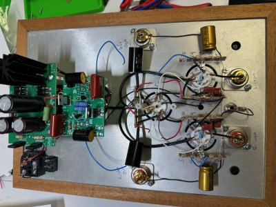

Hi, I'm scratching my head and figured I'd ask the professionals for some help here. Built a S.E.X. last year and loving it so decided to try the Eros2 now. Got the whole kit assembled without a hitch. The only "suspect" thing I ran into was assembling the shunt regulator board- there seemed to be a substitution part for the 100kOh 3W resister that wasn't noted in the kit. Pictured in the manual is a grey resister with 100kOh written on it and in my kit I got a pair of brown-black-yellow-gold but that's 100kOh and it measured out so I didn't worry.
All the voltage tests through the build measured within spec.  The resistance test at the end also seemed fine. When I did the final voltage check everything was very very low.
I took the boards off and inspected everything. Nothing looked off, all solder joints seemed fine but I reflowed most of them anyways. I checked all the board components and reflowed those as well. Made sure the transistors had good soldering. You'll have to forgive my memory with this one- during the disassembly, I can't be sure 100%, but I may have originally mounted the red twisted pair going to 22L to D6 instead of D5. I ran through the entire manual double checking all connections and components as well as reflowing anything that looked suspect.
Now the voltage is a tiny bit higher but still very low:
IA / IB 8v DC, OA 5.2v, OB 6.6v, OC / OD 5.4v, OkA 5.5v, OkB 5.6v, OkC 0.15v, OkD 0.41v.
Where should I go next?  I have some extra 6922 tubes if need be but no 12AU7s or EF86. If that woopsie with the D6/D5 swap actually happened could I have fried something?

I must state that I do not have an Eros 2 but it appears that there are 2 transistors mounted backwards on the C4s board. Q1A and Q1C. Unless the instructions say to do that they are probably shot.

Lee is correct that you have some backwards transistors.
The 220 ohm Rc resistors on your rear shunt regulator board are not where they are supposed to be (I see them up on your front C4S board, which should have caused major voltage deviations during testing).

Good grief, I'm glad to have a set of fresh eyes look it over. Much appreciated!    That being said, can I simply de solder and move these components to the correct positions or did I likely damage something such as the transistors?

Reply #4 on: April 22, 2024, 06:03:10 AM
I would throw the backwards transistors away and replace them.  The Rc resistors currently on your C4S board are probably fine, but be sure to measure them to be sure they are still within spec.  Your 220 ohm resistors are completely dragging down your power supply and should also be checked, but are probably fine since they haven't caught fire.
