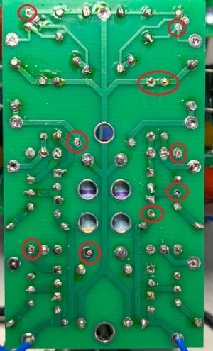

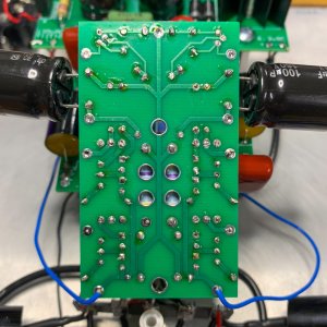

Can I see the bottom of the front C4S board?

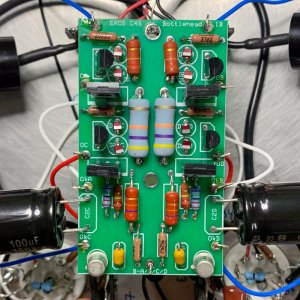

Re: Voltage Check, Issues
Reply #3 on:
August 20, 2024, 05:37:46 AM
Enclosed, photographs, top & bottom, C4S Board (August 20, 2024)
Reply #4 on:
August 20, 2024, 05:49:01 AM
The joints circled in red need attention. At least one of them doesn't look soldered at all.

Paul Birkeland: Okay, thank you – fingers crossed ... will try later today (August 20, 2024).
Reply #6 on:
August 20, 2024, 06:32:48 PM
Paul Birkeland: I re-soldered as you suggested, and I am pleased to report complete success.
All Voltage checks perfectly within spec.
