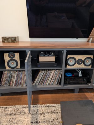

First post here and completely new to tube gear. The overall system is sounding great but I'm running into a volume bottleneck that I believe is because of the output voltage on the Moreplay. Truly loving all the components in the system and wondering if others feel this assumption is correct and what easy fixes there are without changing out gear but more mods or cable attenuator type ideas. Honestly I'm a bit lost in the gain or impedance conversation as it seems needs to be a bigger forethought than anticipated with tube gear. The overall volume is close to what I'm looking to achieve but it's not quite there.
I'm running a Seas driver kit that says 89d sensitivity, those are powered by a Buckeye SS class D amp containing 2 Hypex NCx500 amp boards. Feeding those is the newly built Moreplay, feeding that is a Topping d70 Sabre DAC set at DAC only and output thru XLR to RCA at 5v, also feeding the Moreplay is a Parks Audio Waxwing running thru coax to the DAC but also RCA cables directly to a second input on the Moreplay. To my surprise the turntable thru the waxwing is what I can make the loudest by increasing gain in the DSP of the waxwing but then it says there's clipping and again I'm not sure if that's a bad thing to be sending thru the tube set up. The 5v gain out of the DAC is the max it will go. The Buckeye amp I had chose the buckeye gain stages and those are at high right now, spec states 24.2db gain and 3.4Vrms. I can bypass the gain switches and it will increase to the stock Hypex gain stage of 26.8db and 2.5Vrms. this is where I'm planning to start but before I did so I wanted to see what the forum said.

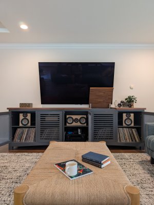

My hopes are there's a simple fix without completely changing gear. Also to pick up some education into any rule of thumbs into this avenue of thought. For those looking at pictures, I will be adding the spalted maple veneer to the face of the Moreplay and painting the rest of it's enclosure black but leaving chassis stock finish. Honestly pumped how it's coming together and to also be getting my feet wet into tubes.
