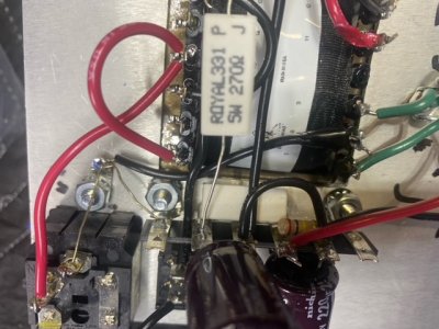

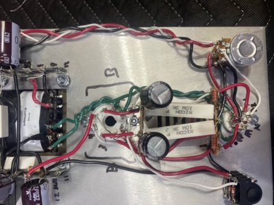

all others ok, build photos attached

8 is connected by hardware directly to the chassis plate.  If this isn't 0, then terminal 3 probably isn't zero either, and you'd have a loose black wire somewhere.  I would triple check that you have OL there and not at 3, as those results are improbable.
22 can be brought to zero by tightening your power transformer mounting screws.

Dont understand how 22 has direct contact with ground since there is a black plastic washer between the metal flange and the chasis. Thanks

If all the power transformer screws are tight they will all make contact with the metal of the transformer cover and pick up the earth reference for the one screw that is tied to the safety ground.
Whatever you do, do not try to force this connection by adding extra wires or removing hardware.  22 can be OL and the amp will function just fine without any safety concerns if necessary.

Terminal 3 is the anchoring point of the power supply to the chassis. Your power supply is not referenced to earth properly, and this is likely from a loose black wire.  We find very frequently that one of the black wires at the headphone jack will be loose and cause this problem.
Please track down the loose/unsoldered black wire and verify that 3 and 8 (and the outside metal of the RCA jacks) all show 0 ohms of resistance with respect to terminal 12.

Reflowed some more black wires and used a solder removal gun to get rid of excess from the previous refl;ows. Lightly sanded the bell around at transformer screw holes and retightened, sanded the plate surface around and tightened the screw holding 8 and the ground tab in the back.  Reflowed the bus wire at the IEC, safety ground lug and 16L
All resistance checks passed/all voltage checks passed.
Hooked up to power, LEDs and tubes light up.
Music-no more scratching/popping, silent volume adjustment and music sounds fine. No noise between tracks.
