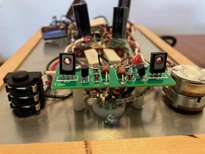

If this file conversion works, here's the first photo, with four more to come.

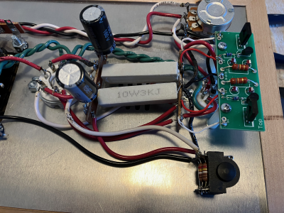

#2

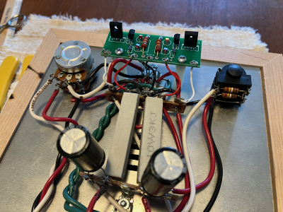

You need to get some kind of award for taking the clearest photos of any customer I can remember in the last 20 years.
1.  All legs of Q2A need more heat and time for the solder to flow out.
2.  R1B appears to not have received adequate heat on both joints.
3.  Both R2 resistors need more heat and time on the joints.
Your LEDs look well soldered and I would leave those alone.
It could be very useful to unscrew the two screws holding the board on, flip it up 90 degrees, then shoot a picture of the bottom of the board and the 9 pin socket.
