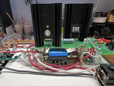

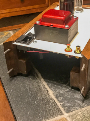

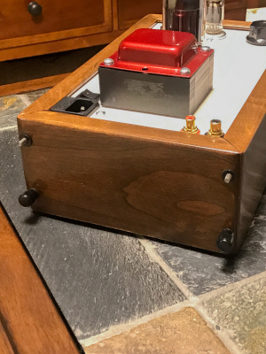

I think I built this Crack in 2017 IIRC. Been sitting on the speedball since then and finally decided I might as well, even though my hearing sucks.

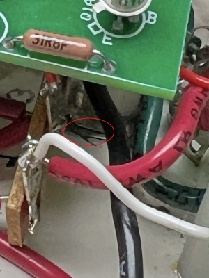

The only real trouble I ran not was the 12AU7 filament wire would not go between the terminal strip and the standoff, so I unsoldered it from the 12AU7 tube socket and was able to bend it more toward the socket. Looks like shite and I may redo the heater wiring to the 9 pin with some 18awg ptfe wire I have that’s about 1/4 the thickness of the stock stuff. But for now all the voltages look good and it plays music. There was a slight low level hum in the left channel independent of  the volume pot and rcas being disconnected. It did lower a little more over the first  30 minutes but I’m wondering if it’s just WiFi everywhere, the severely microphonic 6080, or possibly that heater wire that’s now sitting near the output pins on the 12AU7?

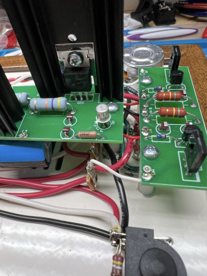

Reply #1 on: November 03, 2024, 02:10:30 PM

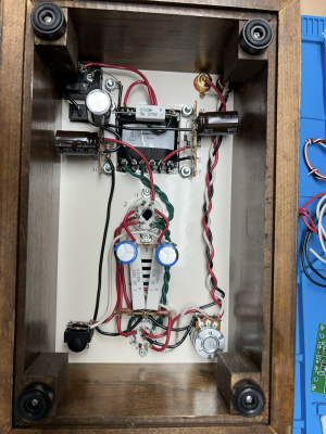

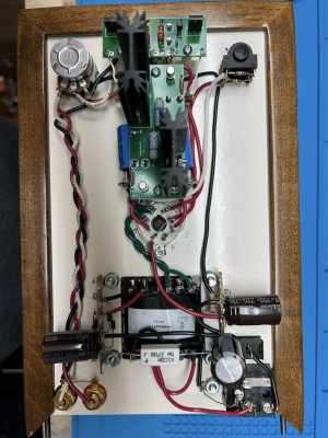

Some other pics.

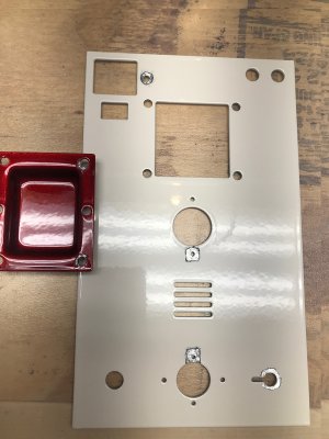

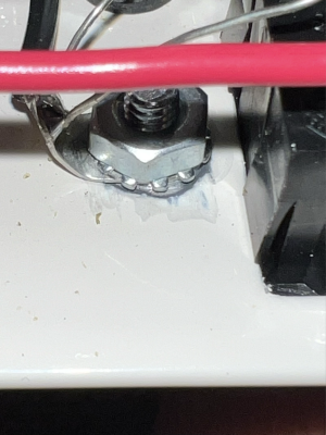

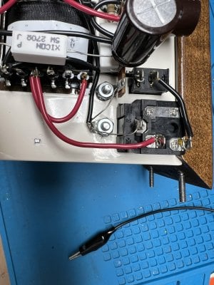

The back side of the panel is painted/powder coated.  This needs to be scraped off for the volume pot, terminal 3 where it touches the chassis, and the safety ground by the IEC power entry module.
It is a little alarming to see that your safety ground looks to be insulated from the chassis, which is far from safe.
I used a dremel and every terminal strip mount and the safety ground  and the volume pot had the powder coating removed. I just didn’t take any more off than the size of the washers. If you look closely at the terminal strip mount/socket mount tab between pins 1 and 8 of the octal socket you can see where  the spot is slightly larger than the tab. Safety ground always concerns me more than anything. I verified them all this afternoon as I was adding the speedball.
Edit: I just went and double checked because. With a clip on the ground prong of the IEC jack every bolt head, and the volume pot all are at zero ohms.
Here’s a pic of the safety ground which has the same size as the internal tooth washer removed and of terminal 3.
