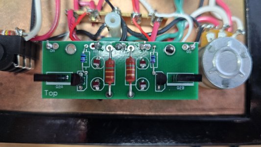

As to regards the LEDs, I have
The four on the Speedball large board - all 4 on.
The four on the small Speedball board - D1 (A side) is on and bright. D2 (A side) not on.
D1 (B side) on but dim
D2 (B side) on but dim
    • Posts: 20221
Reply #11 on: December 01, 2024, 07:08:03 AM
Carefully measure the DC voltage at A8?
If you see ~12V here, then you do indeed have an issue with the LED there.
If you see 0V here, then you'd want to look at the tube itself while the amp is on to be sure both halves of the tube are glowing.  If they aren't, then you probably have a bad solder joint at A4/A5 that isn't allowing both halves of the tube to heat up.
