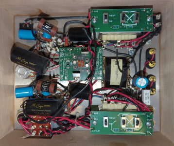

Well, some good news. Taking a picture of the bottom of my amp, I had moved it a little bit while it was playing music and heard some strange things that changed my guess that the switch was bad. Funnily enough, a few of the solder tabs on the bottom of the switch move a little if you put lateral pressure on the switch. This is what I had to do to "get connection" at times... Turns out there was a solder joint that completely failed (was hard to get to when I soldered this switch in) and the wire was just hanging and barely making contact with the solder leg.. hence my intermittent issues. --Currently testing the amp now, no issues so far... It's good to know that you feel a switch is a perfectly fine solution for my use case.

Attached picture of the bottom of my amp if you'd like to have a look.
While I was under there, I noticed some heat damage to the C4S board where the two large resistors are in the middle. I suspect I should raise the resistors from touching the surface of the board.
It's really interesting to look back at all my soldering from when I had practically started around 10 years ago. :P

That switch is certainly overkill.
If you remove the 150K/2W resistors on your C4S board, feel free to replace them with 270K/3W PR-03 resistors and you won't have any discoloration.

Reply #4 on: December 16, 2024, 11:51:17 AM
Will do, thx PB.
