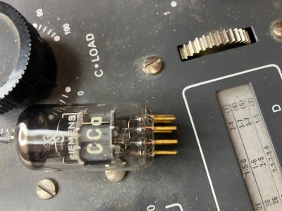

But a box full of NOS, ridiculous-value (today), 6922 types beckons. Have had these tube for years, from back when I could purchase a NIB/NOS 6922 made by Amperex or Mullard for about $25 from Salt Lake Instruments.  And Siemens CCa for about the same. Never had a piece of gear that used them and bought them as they were reasonably inexpensive then and I expected to own something that used them someday.
Now, 20+ years later...
I measured a few of the 6922 types in my tube tester and the CCa's all read as new (or better) so I chose the one with closest halves (94/95) and popped it in.
Not jaw dropping but just a bit more clarity while keeping in mind that clarity is an Eros' strong point.  Thankfully not 'etched' or 'detailed' in a bad way.  Still a bit 'forward' compared to the 12AX7 based phono it replaces but that's to be expected.

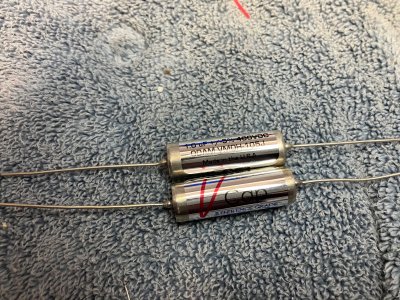

Then an output Cap Upgrade: V-Cap  Oil Damped Advanced Metalized (ODAM). 1uf 400V (pictured below).
THAT is an upgrade.  A $150+ upgrade, but well worth it (IMNSHO).  About the price of a pair of NOS tubes (and cheaper than a NOS NIB Cca) and should last a LOT longer.
Improvements in sound across the board.
I found, out-of-the-box, the Eros 2 was just a bit 'hard' sounding when compared to the 12AX7 phono pre I've enjoyed for the last two decades. Perhaps more detailed and more 'up-front' as well.  Certainly not 'laid back' and perhaps even a bit SS sounding?  Ok, just a bit.
Most all of that is gone.  Still a bit more 'forward' than my old, mellow, tube phono preamp, but not in a particularly offensive way.  More of just about everything good while most of the 'hardness' is seemingly gone.  The clarity and detail remain, without any of the annoying 'detail' that sometime accompanies more 'detail'.
Even think I'm hearing improvements in sound stage, but guessing mostly hearing more of the small details in the upper registers on the extreme right and left that are now somewhat more noticeable.

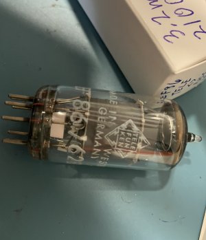

After a bit of work, I acquired 2 each NEW/NOS Telefunken EF86, albeit at ridiculous prices.  Took a while to find,  but a few phone calls to old contacts in the business worked out well.  These are the real deal (pictured below).  Again, at a ridiculous price. Half the price of the whole kit!  But then the stock kit is likely the equal of an off the shelf, commercial tube phono going for 3-4 times the price. So half its price but NOT half its value!
Verdict?  Worth every penny!  Harmonic richness is up quite a  few notches. Not a hint of nastiness anywhere to be heard, but then there was none with the old tubes.  Re-issue of Procol Harum's A Salty Dog was a revelation.  45 rpm 'Julie Is Her Name' never sounded better.
