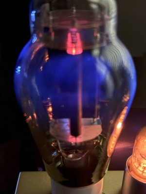

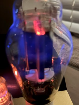

Hello all,
I am new to tubes and have a general inquiry about tube glow. Both 2A3s on my amp appear to have a blue glow on the inner glass and bottom plate only really visible under low light conditions. How normal is this? Note: this is not a BH amp.

It will go away, enjoy it while it lasts.

https://www.jacmusic.com/techcorner/ARTICLES/English/blueglow/blueglow.html
There's lots of info here.
Certainly looks like 'Fluorescence Type 1' and decidedly...normal.
