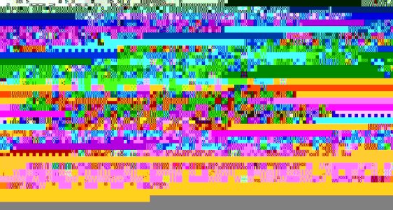

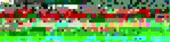

I attach the impedance drawing and the specifications and kindly ask you to take a look at the specs and throw some light on what I experienced or maybe make a reasonable guess re what I should expect.

I play my stereomour at about 2/3 volume with speaker cabinets listed at 99db. Its loud but not too loud. It has excellant bass especially when considering its only a 3 watt amplifier. You may need more efficient speaker cabinets but give your cabinets a try.
Clifford Hard
