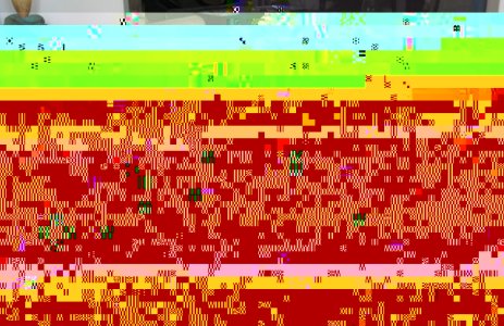

I did the same thing with my Extented Foreplay III. The Foreplay uses 6CG7s. The power supply is on the left and the tubes are on the right on their sides with the tops pointing in the direction of the right side panel. I used this terminal board that has 3 tubes sockets http://www.partsconnexion.com/product3167.html. I also installed a power filter and remote step attenuator.
