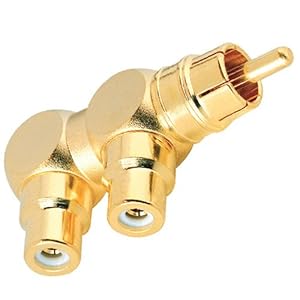

I'm thinking of making a Quickie to use with my Seduction and SEX amps. Would this be a good fit? Ideally I would have three inputs, but I figure I can upgrade to the new Foreplay later.
I could always use one of these to take care of the extra input.

So I'm using one of those adapters from AudioQuest on my just-completed Quickie. But it seems to be negatively impacting the sound quality. How is that possible?
I have the Seduction and a CD player plugged into it and into one of the two Quickie inputs. With the CD player opn stand-by the quality of the Seduction just plain stinks. But strangely enough, even though it's better, when I turn the CD player completely off, the sound still is much worse.
Do these adapter simply not work? There's still a signal coming from the CD player, even when it's off?

Reply #14 on: September 13, 2012, 01:06:59 PM
The Seduction and CD player are in parallel.  Rather than the Seduction "seeing" the impedance of the Quickie volume pot the output of the CD player is in parallel with the pot.
Your problem is the interaction of the two source outputs with each other.
The adapters are very effective on the output, I split my FP 2 output to a sub and my Paramours.
