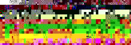

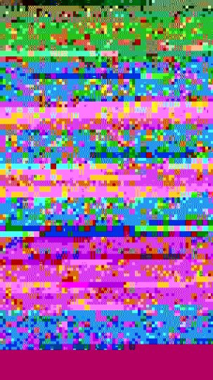

Ok, here are some of the pics I promised. The first is my home built tube amp based on a JE Labs circuit once posted on angela.com. The second is the glue-up of my Crack base. I plan to use Cherry Watco Danish Oil to finish this. The third is a pic of the powder coated (textured black) chassis plate. I had the transformer bell housing powder coated as well. I found a local shop which only charged $25 and turned them around in 2 days.

I did a first test fit of the chokes and caps for my upgraded power supply. Choke #2 mounts to the transformer forward bolt and the safety ground bolt. This is a tight fit on the spacers since the spacing isn't exactly correct. Choke #1 mounts the same way on the other side with a hole drilled (at the correct spacing) to mirror the safety ground hole. The chokes don't protrude past the box boundary using 1 3/8" spacers. Cap #1 (470uf 250V Nichicon PW) will be secured with a cable tie down bolted to the panel (leads insulated, of course). Caps #2 and #3 (Mundorf 20uF film TubeCaps) will mount with the same method but stand(hang) vertically (again, leads insulated, of course). Cap#2 slides right in between the two chokes and sits against the box. The caps could easily lie horizontal if I used slightly longer spacers. So, now three more holes to drill for the power supply cap tie downs. And there is still room for big output film caps so I may drill four holes for their tie downs as well to be ready for that future upgrade.
Yes, that is a PEC pot peeking from the bottom of the photo. I plan to use a shielded cable from the RCAs.
