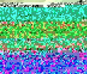

It looks like i already have 0.15 ohm hope pic came through
tony

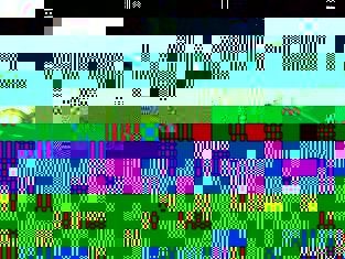

in my photos is that the resistor we are talking anout? if so and if i am measuring it to be  0.15ohm the i am good to go with plugging in my 6sn7 by way of adaptors correct?

Huh that's a little strange.  If it had been using 3 x 12au7's the resistance of the heater should be ~0.41ohms.  If it is only 0.15 then the voltage to the 12au7's would be way off.  Is there a decimal place before the 15 - it's not clear in the picture?  And there are no others going across the same terminal holes?  A multimeter checking resistance might be good piece of mind.  If it really is 0.15ohms then I think you are good to go.

The 0.15 ohm resistor is in series with the heaters and the smoothing capacitor.  It is a minor voltage adjustment for the circuit to deliver just enough voltage without stressing the heaters due to high voltage.

yes I was careful to look at the brown resistor and it did have
0.15 on it. ( POINT 15 ohm) I will check when I power down to see if there is another resistor i parallel to it later tonight.
