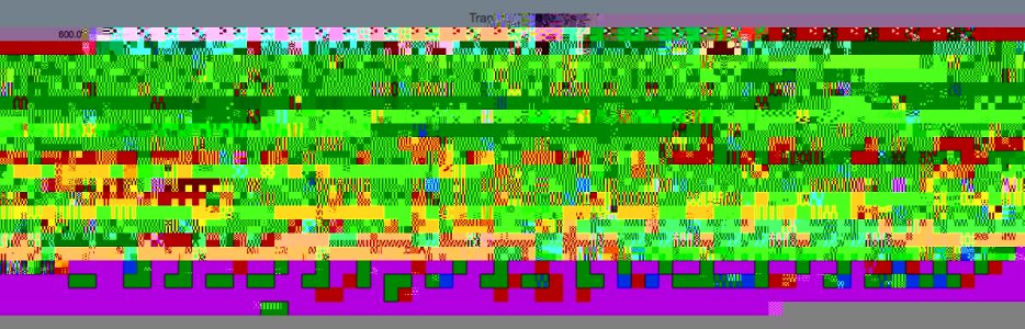

Reply #14 on: February 08, 2013, 07:17:17 AM
My kit should arrive on Monday so I have had time for one more simulation. I put the entire schematic in the circuit lab simulator. I modeled the tubes as voltage controlled voltage sources with offsets to account for the bias points. The simulation results agree very well with the documentation. This only shows that the simulation is more or less correct; we already know the design is. The constant current source outputs just under 4 mA. The 2A3 bias current is 50mA. It took the model 0.5s for the circuit to stabilize. I used a 2V p-p 1KHz signal for the input. As you can see from the waveforms, The grid voltage on the 2A3 swings from -58V to +58V. I did not show it, but the plate voltage on the 12AT7 swings from 136V to 252V. You can also see the phase shift of 180 degrees between the first and second amplifier stages. The plate of the 2A3 swings from just above 500V down to a little below 200V. On the other side of the parafeed cap the signal is shifted to be centered  around 60V. The output of the transformer is +2.24 to - 2.23 into an 8 ohm resistive load. It was very educational to see all this working together.
« Last Edit: February 08, 2013, 09:22:28 AM by rlyach »
