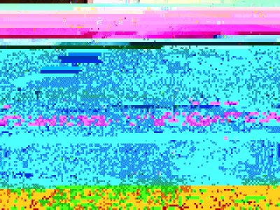

first of all an elma selector switch:
Xavier Cortes
Offline johnsonad
    • Posts: 1670
Reply #1 on: March 02, 2013, 02:42:00 AM
Xavier, are you only using two inputs correct?
Offline xcortes
    • Posts: 997
Reply #2 on: March 02, 2013, 02:57:09 AM
yep

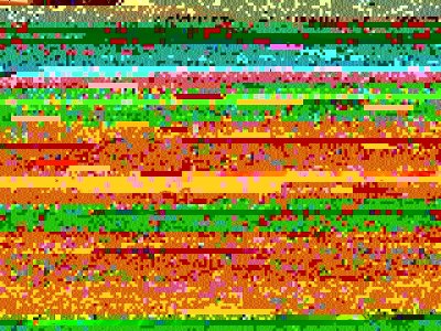

wiring the inputs. belden 89259 instead of the cat5:

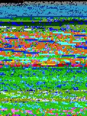

the other end:

Offline johnsonad
    • Posts: 1670
Reply #5 on: March 02, 2013, 06:38:10 AM
That looks like a PITA to work with.
Offline xcortes
    • Posts: 997
Reply #6 on: March 02, 2013, 06:52:14 AM
actually it's not that bad

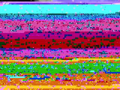

Good call on the black jacks, this will be a neat build in the end!
I'm surprised you didn't go for the black connex UX-4 sockets to top it off!
Offline xcortes
    • Posts: 997
Reply #8 on: March 02, 2013, 07:45:38 AM
actually i had the two pairs of black ones and used those for the input. used the four pairs in the kit for the outputs. i'm cheap, you know?

the soldering of the second input to the selector was indeed a b@tch!
