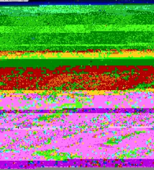

I spent the whole day on the cabinet / box. I wanted to make it look a little more standard, so I used tolex, corners, and feet. I also got a leather handle. Now I can start on the electronics... Yeah. I like the way the cabinet turned out, but tolex glue is really messy to work with. Also, if anyone is interested in using tolex, I did have to deepen the rabbet to make room for the tolex.
