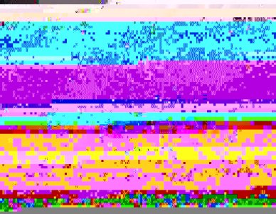

We are getting closer to being ready to take orders. I'm hoping for a prototype panel from FPE in the next day or two, which PB will build up in a manner based upon his rough layout pictured here, which is currently sitting on my desk. This layout is somewhat confusing because some of the components will actually be under the chassis, some on top.
What you see here is:
The DAC board in the front, inside an extrusion for shielding. This will hang under the chassis. There will be a slot on top with a socket for various forms of sample rate indicators and other cool things John is scheming on, and the USB, TOSLINK and Coax inputs are located there.
obviously the tubes will be on top, along with power switch, IEC power entry, and RCA jacks.
Those three chokes will be underneath, as will that board with the small power trans and power supply caps for the low voltage stuff.
The big power trans will be on top, with a PC board underneath for the power supply.
Not all of the firmware for high res and USB is done yet, but we should be playing 44k and 48K files via optical or coax as soon as we get it together.
And if you read this John, one of the extrusions is on it's way to you -

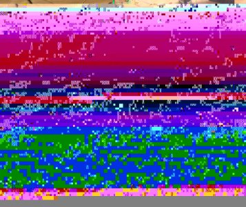

Had a nice long conversation with John Swenson today. We have a pretty exciting new development that could make the DAC USB2.0 and 192kHz compatible right out of the gate, offer more options for DSP, have a little more user friendly layout and construction, and several other improvements (including sounding a little better). John is working on a new layout for the DAC board and we hope to have it in house by month's end in order to keep our current goal of an early summer release in sight.
PB got construction of our latest prototype about 80% complete today and we hope to be giving it a listen Monday afternoon. This is not exactly what the final version will look like. It will be a bit more finished around the display board area and may have fewer tubes. But you can get a general sense of where we are at.
