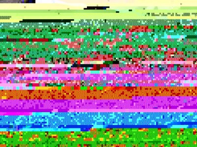

Here is a picture of how I eliminated hum by clipping between the top of my foil wrapped tube and ground. Wow, did it clean up my sound and add definition to bass too, my wife will even attest. Strange, strange hobby.

Ok, now I gotta try it. I like the looks of Herbies tube ring to keep it in place.
Reply #2 on: April 07, 2013, 11:50:48 AM
It makes sense that a tube shield doesn't do anything till it is grounded.  Although most guys don't need to shield the tubes in the Quickie.  But each of us is in a different EMF/RFI location.  I think I'm in good stead since my house is behind a lot of rock!

For anything metal to be used as a shield, like a tube damper or tube shield, it needs to be grounded.  This takes the noise/RFI/EMI to ground potential.
