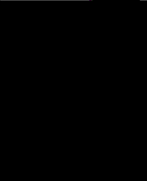

This next part is mechanically tricky, because the diodes are bulky and have stiff, fat leads. You want to make a fullwave bridge from the transformer terminals to the two closest lugs of the terminal strip, right above them. Mark one of the lugs + and the other -. I'll attach a circuit diagram.

There should be about 4.8vDC on the 300B filaments; all the other voltages and resistances should not change.
You can remove the Bench hum cancellation circuit if you want, or just leave it in and turn it down all the way, which might be easier. You'll need to retain the large hum pot in any case. To remove the Bench cancellation circuit, remove the 2uF cal, the 10k trimmer, and both 1N914 diodes.
Be sure to adjust the large hum cancellation pot for minimum hum. This power supply has about 30dB less hum than AC filament power, but it still has a little, which can be trimmed to a minimum with the pot. The hum will be at twice the previous frequency, so the 120Hz component can be trimmed out leaving a slight 240Hz component.
