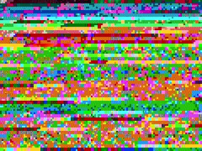

Reply #5 on: May 23, 2013, 07:59:35 AM
If voltages are good, here are some possibilities for why the output is low or not there at all
Voltage good
Input and output cables reversed.
Hooked back up to Sansui making sure cables not reversed. Same low volume muffled sound.
Input or output jacks shorted by a solder bridge between the center pin and the outer shell.
I don't see any bridging
Switch contacts compromised from overheating - I suggest this because of the loose lug you mention. The switch may have been damaged by heat but I don't know how to determine that.
Here's a pic

Reply #7 on: May 23, 2013, 09:08:25 AM
OK, you had sound initially, and then you changed some stuff and now you have no sound. So go back and inspect the things you changed. Are the reconnected parts connected to the proper terminals?
