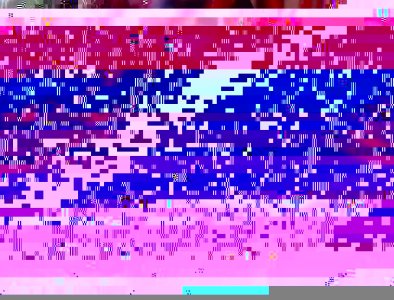

Reply #6 on: January 02, 2014, 02:29:46 AM
this is the jj electronic 12au7 i'm using
Online Paul Birkeland
    • Posts: 20297
Reply #7 on: January 02, 2014, 05:53:14 AM
I can't quite see in the photo, but are the two lugs of the volume pot that have black wires going to them connected together?
    • Posts: 9790
Reply #8 on: January 02, 2014, 06:26:15 AM
I can't quite tell from the photo, but does it say ECC83? That's not right. A 12AU7 is an ECC82. ECC83 is a 12AX7, which would glow but not draw enough current. Is that the tube we supplied?

Zooming in, it does read ecc83...Try the stock 12au7

Bingo that's probably it!
The original 12AU7 broke when i was taking everything out of the packaging. I bought a new 12AU7 through amazon. I received a box that said 12AU7/ECC82 - however i didn't notice that the print on the actual tube says ECC83S. Apparently the tube was mispackaged.
