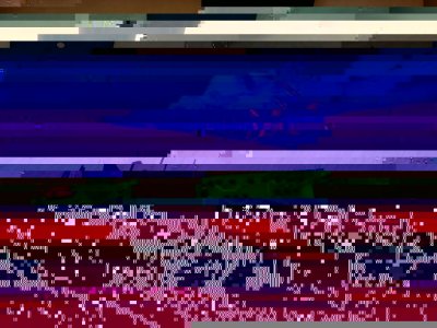

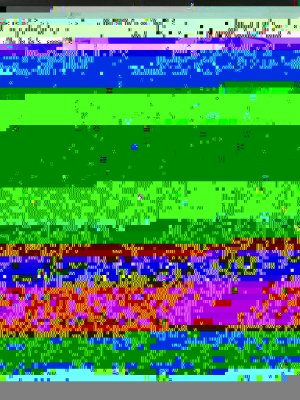

Hello BH's,
Last december I got my BH Crack with Speedball package. I solderded the Crack and it sounds great.
Today I wanted to improve the Crack and I was ready to install the Speedball.
Accidently I soldered the MJE350 in place of the TIP-50,  same component but slightly different.
I came to the conclusion that the TIP-50 transistors are missing.
Thankfully I could save the MJE350

I am going to solder the MJE350 to the smaller boards. I know for sure that I didn't overheat the MJE350's.
The heatsink, I'll give it another try to remove it.
