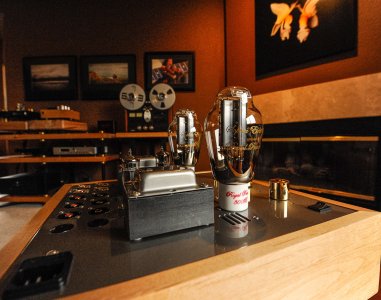

I tried to paint mine and learned I am a hack with a spray can. Gave up and took the plate and tranny caps to the auto body shop. He had paint loaded for a silver Mercedes. Worked for me.
The alder frame was much easier. Lots of sanding, tack off clean, wipe on clear ZAR tung oil finish then steel wool smooth. Repeat finish. Light coat of carnuba  wax.
You will love the BeePre!
Enjoy,
Kevin
    • Posts: 9756
Reply #5 on: February 26, 2014, 08:32:33 AM
Nice photo!

That's a nice BeePre.
I found the former suggestion of powder-coating brilliant and found a place nearby that will do that, on any side part.  I plan on taking my top plate there.
