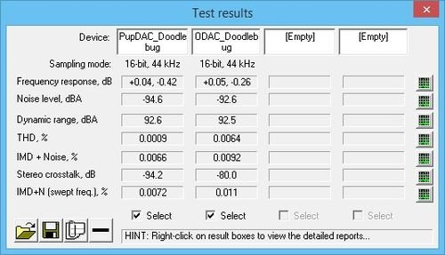

Reply #14 on: July 02, 2014, 02:57:06 AM
Welcome.  There is a Bottlehead DAC in the works but it will be in the four digit price range so not really comparable to the above.
I made the comment above that i suspected the PupDAC wouldn't measure as well as the ODAC.  Since then i have played with RMAA and made a few measurements and found the opposite to be true.
