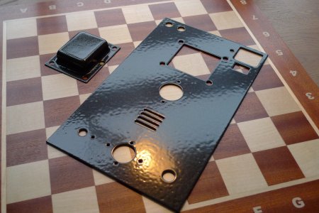

Reply #8 on: April 05, 2014, 07:42:12 PM
Looking good so far. Had some blob on the bell, sanded and recoated.

Reply #9 on: April 05, 2014, 09:12:28 PM
Looking at the pic inspired me.
It had me wondering if cutting up a old chess board might make a neat enclosure for a crack.
