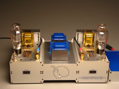

My Bottlehead Customs 2A3 amp used National Union tubes initially, but I rolled the JJ 2A3-40 tube into the amp and the differences were not subtle. Search for my posts (Hank Murrow) in the Gallery section of the Forum to see pics and detailed listening notes. I have had these tubes in the system for a couple of years and love them. Eurotubes in Portland, OR was the supplier, and they offer the best warranty.

Just so we all understand... The 2a3-40 is wired as a 2a3 but you keep the heaters wired as you would for the 300b?
    • Posts: 5833
Reply #6 on: April 18, 2014, 07:56:34 PM
The 2A3-40 is a 2A3 - wire the heaters for 2.5 volts. Since it can take a lot more power than a NOS 2A3, you can wire the rest of the circuit either direct-coupled 2A3 or cap-coupled 300B.

Reply #10 on: February 21, 2016, 07:52:23 AM
Ok.  I just got done rewiring the FC-1 and chaged the black wire from the 5v to 2.5v solder pad on each amplifier.
Is there anything else i need to address, other than adjusting the hum pots for the new JJ 2A3-40 tubes?

Thank you for digging that up for me, but that isn't exactly what I was asking.
I was going by this guide, which is basically the same information just simplified and all in one place:
http://bottlehead.com/paramount-300b-to-paramount-2a3-conversion/
I know that following ALL of the steps will convert the amplifiers to 2A3, my question is in regards to optimizing the Paramounts for the JJ 2A3-40 as described above (changing the filaments voltage to 2.5v and leaving the rest as cap coupled 300b).
From what I have gathered, it seems like following steps 1 and 2 from the guide I linked, will accomplish what PJ and PB have described above.  Is that correct, or is there anything else that needs to be done that I am missing?
BeePre, Paramounts 1.1, Eros, Thorens TD-124/AudioMods Tonearm/Ortofon 2M Black, IFI Micro Idsd, HQPlayer,  Altec 604-8G Duplex/620 Cabinets/Markwart Crossovers
S.E.X. 2.1, AKG K701
Reply #13 on: February 22, 2016, 05:28:32 PM
Yes, in theory all you need to do is change the filament supply since a 2A3-40 is pretty much a 300B with a 2.5V filament.
Offline marantzfan
    • Posts: 148
Reply #14 on: February 22, 2016, 05:52:30 PM
Thank you Dan.
I just wanted to confirm, as after doing that I popped in the JJ's and while trying to adjust the hum pots, I noticed that one amplifier was fluctuations from 0 to 12 mv, constantly without moving the pot.
I decided to give them a listen at low volume and noticed an intermittent crackling sound from the side that was givin me the odd readings, but I could certainly hear music over it.
I powered everything down, swapped the tubes and noticed that the crackling sound (and readings) followed the tube.
So what does this sound like?  Bad output tube?  Nothing else has changed.
« Last Edit: February 22, 2016, 05:54:02 PM by marantzfan »
