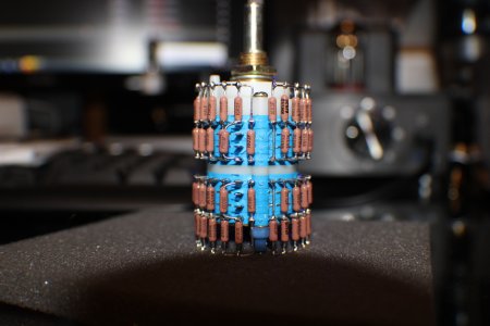

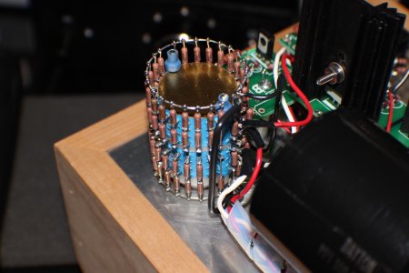

I received this great looking pot the other day and I'm having hard time figuring out how to wire this beast ,I would appreciate some help ,this is what I was able to get from the seller
and the stepper
EDIT; if someone could point out where each wire should be soldier it would be great
Thank you

Reply #1 on: April 18, 2014, 03:19:13 PM
"In" comes from the RCA jacks, "Out" goes to the tubes, "Ground" is all the black wires.

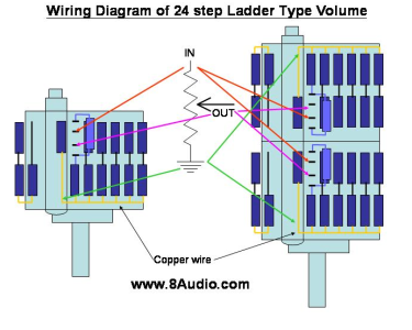

I'm getting confused when looking at the diagram ..it looks like the diagram shows two pots or this is one pot ,just two  different view  since I have to connect two black wires ?
Reply #3 on: April 18, 2014, 03:26:50 PM
The diagram shows two different controls.
You should be able to look at your control and determine which side of the drawing applies.

Reply #5 on: April 18, 2014, 05:53:55 PM
The yellow rings on that drawing aren't connected together.
The ground lugs of the pot on the Crack are wired together.
You will need to wire the ground rings of the new control together, otherwise you're in for some unpleasant issues.
Reply #6 on: April 18, 2014, 09:58:31 PM
Tried a google image search of dale stepped attenuator and came up with these
(https://forum.bottlehead.com/proxy.php?request=http%3A%2F%2Fi10.photobucket.com%2Falbums%2Fa150%2Ftubesforever%2FAttenuatorSchematic.jpg&hash=7736e317b77446ee72dab8829c3763690497a519)
http://kikitronic.blogspot.co.uk/2009/11/dale-23-steps-attenuator.html
http://www.aliexpress.com/item/4x-24-Step-50K-Stereo-Attenuator-Volume-Control-Pot-Log-Free-shipping/482073639.html
Reply #7 on: April 20, 2014, 07:35:49 AM
The pic Jamie posted says it all, there is no dedicated ground lug so you have to solder the ground wires onto the ring instead.  As PB said make sure you join the two ground rings together.

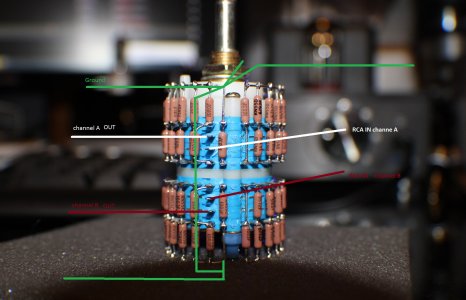

Reply #11 on: December 27, 2014, 03:24:21 PM
I'm getting ready to install this same attenuator but the pins seem a little different than what was originally mentioned in this thread.  I've created a diagram of what I'm working with and what I plan to do.  I was hoping someone could do a reality check for me before I start soldering.  Any assistance would be greatly appreciated, thanks in advance!
(https://forum.bottlehead.com/proxy.php?request=http%3A%2F%2Fi.imgur.com%2FtlWdQRL.jpg&hash=9cc9a9e7cf0e4b3f1c43d374a5a261e3be1596d5)
Reply #12 on: December 28, 2014, 05:08:19 AM
Your judicious use of heat shrink tubing makes me smile.  That looks like a professional installation.
Assuming the red in each cable is that channel's signal common your wiring looks spot on to me.
Tying the two signal commons (grounds) together before taking it to the safety/chassis ground is simplicity (I mean that in a good way).

Reply #13 on: December 28, 2014, 06:07:14 AM
@MJS242 look at my  diagram  and the pick from manual (green is ground instead of black in manual picture ),yes 3,5,6 are ground and then you just connect/ground- top/bottom ring
