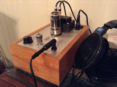

Just completed my first DIY project.  First time soldering and everything came out right the first time.  The Crack sounds great using HD600 and Koss Pro 4AA.  This took several nights going real slow and careful.  Just starting on the Speedball.  I realize that I need a smaller "gauge" solder - 0.062" is too big.  I'm guessing a smaller gauge solder will heatup faster and make it easier to do the CB work.  Thanks Bottlehead.

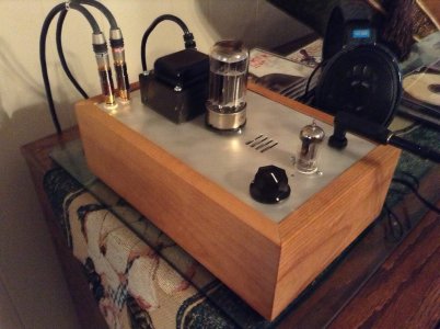

Let's see if this works:
First pic shows the in-line attenuators (from Rothwell)
Adrian C.
Offline JamieMcC
    • Posts: 1171
Reply #7 on: April 22, 2014, 12:41:27 AM
Neat job are those some kind of spacer on your RCA inputs?
Offline Adrian
    • Posts: 278
Reply #8 on: April 22, 2014, 02:52:45 AM
JamieMcc:  Those are in-line attenuators.  They reduce the high input source line about 10 dB.  This allows me to operate the volume pot near the mid- range (12 o'clock) and give finer control over the lower volume settings.  Most source inputs today have too high a line signal and could probably go directly into an amp w/o a pre-amp.  This is a case for a passive pre-amp (selector switch and volume control only) when appropriate.
