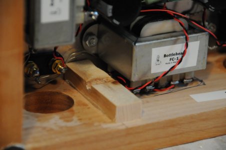

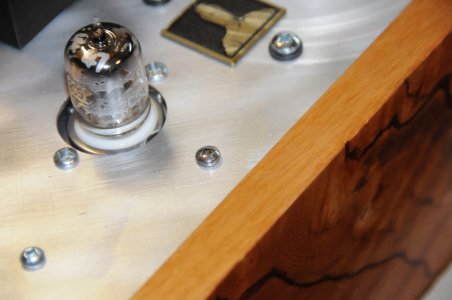

All my Bottlehead plates are attached to the base as shown on the photos. I glue 2 small pieces of pine on 2 opposite sides; I drill two small holes in the plate and insert a small stainless steel screw. I leave a gap of about 1/8" between the plate and the top of the piece of pine. Screws are just snug.

Looks great Guy.
Yep, looks like the way to go. I like Doc's Alderwood bases - maybe I am just used to them, so Id like to keep "stock" bottlehead look.
Cleet
