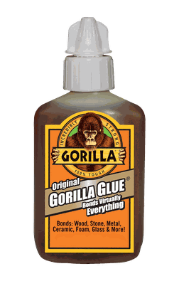

Gorilla Glue ie (polyurethane glue) will work well for this it is reasonably inexpensive and easy to find.
I used it to glue my carbon fibre top to the alloy plate with it when and when curing the clear coat I used a infer-red lamp on it 90 degree Celsius the different expansion rate of the alloy to the carbon was enough to bow my Cracks top plate like a banana but all remained stuck solid. I use it for gluing all kinds of stuff and it continues to amaze me at what it will adhere to.
The only thing I would advise caution on is if you intend to use a very thin veneer many of the liquid glues will penetrate through the wood to the top surface making it nigh on impossible to make the veneer take a stain which can give a uneven patchy finish.
You will need to sand and degrease the alloy plate for a good bond and a thin coating to each surface stick together and place something heavy on top.

Yup it will make a very permanent bond. You will never get the panel out of the base without breaking the wood. It will also expand and blow out of the seam if you use too much. The glue will stain your skin.  Keep those things in mind and it's a really great adhesive.

The Gorilla glue gets messy if you use to much the best way to apply it to the top would be to pour a little on and spread it out with a old credit card you only need a very fine film on both surfaces. If you used the credit card to scrape any movable excess off you will have about the right amount do the same to both surfaces and put masking tape over any surface you don't want to get glue on. This helps later finishing later on.
What ever you do never ever use a silicon based caulk/glue on anything that's going to have any kind of finish coating even the slightest trace of it from a fingerprint etc will cause paint finishes to wrinkle or fish eye.
