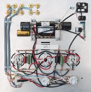

The manual is being wrapped up. I will start kitting bags for the first run today or tomorrow. We are still waiting on chassis panels before we can ship any. Additionally we have several backordered items for this kit. We always ship in the sequence that orders are received. In other words, the early guys will ship first. I believe parts on hand will get the ones ordered over the first weekend out as a first batch (i.e. if your order date is April 21 or prior), playing catchup on later orders as our backorders come in.
As for the wait time, we are actually doing quite well. Dan estimated 6 weeks on April 18. 6 Weeks from then would be next Friday, May 30. We will almost certainly ship out the first kits on the day the chassis panels arrive. My hope is that will be before next Friday, but it is somewhat beyond my control.
I have attached the picture of the bottom side of the completed preamp. We haven't had this shot before as there were some key differences between the prototype and the one built for the manual.

Reply #11 on: May 21, 2014, 07:28:21 AM
I like the little filament supply PCB, neat idea :)

Reply #12 on: May 22, 2014, 05:25:39 AM
Excellent! That looks like it will be a pretty straightforward build. I am looking forward to getting my kit, whenever it it ships.
Is that CAT5 used for wiring the terminals?
S.E.X. 2.1, AKG K701
    • Posts: 20281
Reply #14 on: May 22, 2014, 05:45:52 PM
A particular grade of CAT5 is used for wiring to and from the RCA jacks.  It's good sounding wire, pretty space efficient, and much easier to work with than any other shielded cable we have used so far.
