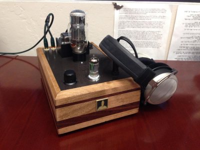

The photo of your "Office Crack" left me a bit awestruck. That's one of the best looking builds I've seen. If you don't mind my asking, did you do it yourself? Where did you get the wood base?
Also, what specific tubes are you using?

I built the base myself. I started with the standard Bottlehead base wood and did a double inlay using east indian rosewood. The inlay is 1/4" thick. The lower inlay is 3/4" wide and the upper is 1/4" wide. Then I used a 45 degree router bit to put the top edge on the base to take away from the bulky look. I spent a lot of time sanding and went down to 600 grit. Then I rubbed several coats of Danish oil (walnut) on the base and finish with briwax, applied with #0000 steal wool. After the wax dried I buffed it with a car polisher. The hardest part was cutting the inlays to get a perfect fit.
The 12AU7 is a balanced NOS RT long plate. The 6AS7G is a Mullard rebranded Svetlana tube. I like the tubes very much, but as you know, there are almost an infinite number combinations of tubes to try  ;)
