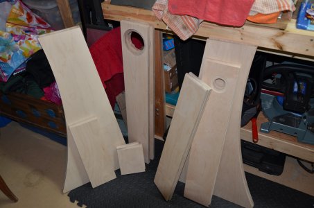

I have received my Frugel Horn 3 flatpacks and Alpair 7en speakers from Planet 10. I will be driving them with my Stereomour and Reduction phono amp. The kit is beautifully executed...all panels being cnc machined. I'm eager to get these together and audition them. I have decided to use the less efficient Alpairs, but from all accounts it's a superior driver to the Fostex units. I'm presently searching for wood veneer for the build. Not having any experience in veneering can anyone tell me whether the panels should be veneered first, then assembled, or once the cabinets are compete? I will post some additional photos as I make progress.

Yes...Baltic birch, but I thought I'd try something a little more exotic and to finish the exposed ply edges.

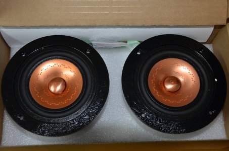

The kit, enabled Alpair drivers, shipping and taxes came to $750.00 USD. Shipping amounted to $75.00. The flatpacks are $290.00 and the drivers $290.00. I paid ten percent less for the drivers as I ordered them at the same time as the flatpacks.
I have never heard these speakers, but have purchased them after extensive research on the web, (Planet 10's site and diyAudio.com, builder reviews etc.). I listen to most types of music with the exception of country. From what I have read the Alpair driver will produce "substantially" more bass than the Fostex 126(en) driver, however at the cost of some efficiency. The Fostex driver has also been described as more "shouty??" than the Alpair driver. Further, the Alpairs don't seem to be as demanding as far as being corner loaded.

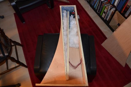

I have been delayed in completing my speakers for some time. They are now assembled and running with my Stereomour. However, I only have about 130 hours of run in time on them to date and have yet to install the acoustic batting in the front section of the horn...the sides are clamped temporarily. I was terribly disappointed with them the first time I heard them, despite being aware that they require a break in period of some two to three hundred hours or more! That said they now sound altogether different. I think with more time on them I'm going to be very happy with them. Bass and imaging are vastly improved. From what I understand the stuffing in the front of the horn is to attenuate the amount of based being produced. At this point I wouldn't characterize the bass as being anywhere near excessive, but the low end seems to be developing nicely. Once I have another hundred hours or so on them, I'll add the stuffing to the front of the horn to see what difference it makes. My speakers are in the corners of a very small room...9 x 10 feet.
