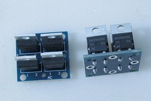

I have some Crees on hand as well but as yet have not found a eloquent enough method of implementing them the closest I have got is considering using one of these pcb boards mounting it separately with lead outs to the Crack terminals. I decided in the end that perhaps it would be best to leave well enough alone and save them for another build as it would be easier to implement from a fresh than retro fitting.

Yeah, it's tough.  A PC board will work, but then you have to consider how you're going to keep that PC board stable, as you don't want it twisting around and allowing those little metal tabs to touch other parts (especially if you have added chokes or big caps).

Paul, totally agree it would need properly mounting on stand offs or a non conductive board fixed to the top plate, one of the ideas I was thinking of which might offer a safe solution was after mounting them on the pcb would be then potting them. I and had been meaning to ask if such a method might be a suitable.  Possibly in a small tube or box and then filling it with a resin or high temperature hot glue to cover the Crees's and tabs completely.

PCB boards are a good solution, once they are well soldered on you could use these http://www.ebay.co.uk/itm/TO-220-Transistor-Silicone-Rubber-Cap-Insulator-x-10-/150665380021?pt=UK_BOI_Electrical_Components_Supplies_ET&hash=item23145b40b5 for a bit of insurance.   Of if your cheap just a length of heat shrink around them.
