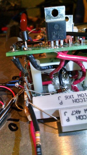

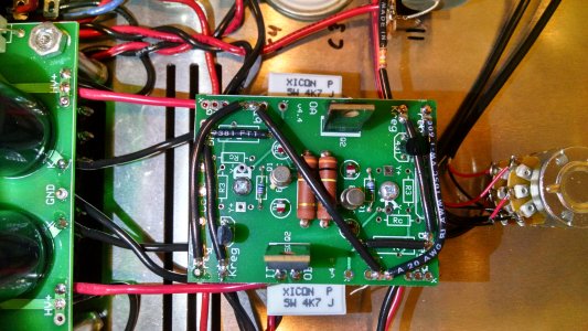

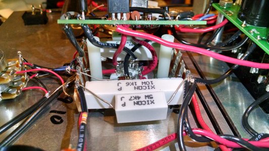

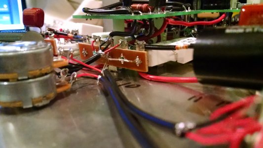

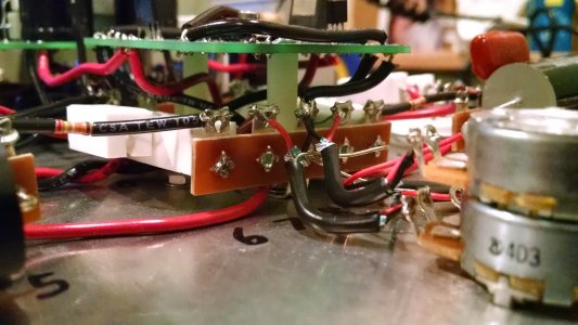

Can you remove the screws that hold your C4S board down, tilt it to the side, then post a photo of the 9 pin socket area?  If possible, include both the 9 pin terminal strips.

Just to be sure, I put the tubes back in a fired up the amp for a moment.  Still reading 4V DC on A1 and A4.
I hope these photos help.  Let me know if you need any other shots.

Is there a jumper between terminal 6 and terminal 8?

Yes, It's there.  It loops from 6L to 8L on the rear facing side of the strip, then loops from 8L to 10L on the front facing side of the strip.
I see what you mean that it's not clear in the photos.  Just to be sure I measured resistance between 6 and 8, it read about 0.1 ohms.
