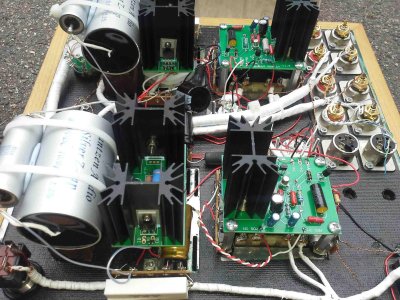

Do you happen to have any photos of them installed?  I just got the Jantzen caps and the BeePre kit and this is looking like a really tight fit.

Sorry I was busy the last few days and just saw your request. There is a lot of room at that end, but to help keep the caps out of the way I put a block of wood behind each terminal strip to raise them up and away from the other components. (super glued, drill holes and zip tie the caps)
