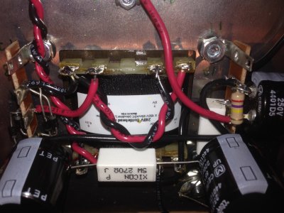

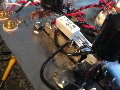

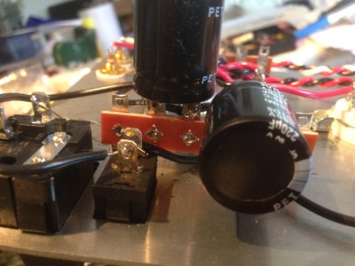

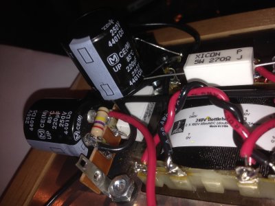

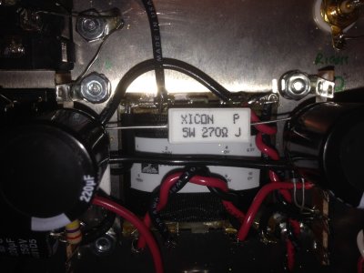

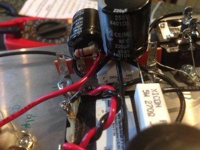

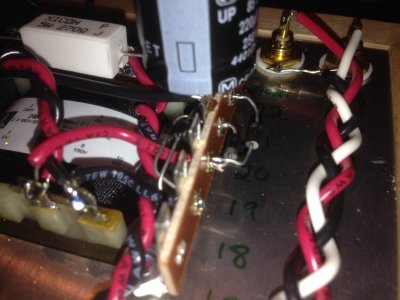

Can you post an image of the wiring around the power transformer? My hunch is either the meter is giving incorrect readings or there is some issue with the transformer wiring. Also, could you set your meter to AC Volts and very carefully measure the AC voltage across pins 6 and 7 (black lead to 6, red lead to 7) of the power transformer and then measure the AC voltage across pins 9 and 10 of the power transformer? You should be seeing somewhere around 150 to 165 Volts AC. Possibly a bit higher. Set your meter to the 500VAC range or higher to be safe.

Offline tweedgv
    • Posts: 36
Reply #13 on: October 31, 2014, 05:44:49 AM
couple more pics
    • Posts: 9794
Reply #14 on: October 31, 2014, 06:44:52 AM
OK, set your meter back to DC volts on a 500V or higher range. Measure again with the black test lead attached to terminal 12 and the red lead attached to terminal 13.
