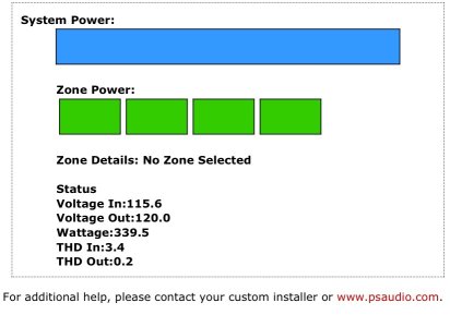

Reply #14 on: November 15, 2014, 11:42:46 AM
Ps audio p3 arrived.  I replaced the breaker on that circuit with a new cafci  breaker.  Voltage droop was marginally better.  Silver paste still in the ups truck, due to be delivered today.
With p3 in the system and burning in, initial impression is sound improvement.  The best way to describe dynamics is 'effortless'.  Funky noises that I had when the plasma tv was on are gone.  Even with input voltage at 114.7, output is steady at 120.  Incoming THD is 3.4% output is 0.2%.
Will wait a bit for more critical listening and application of silver paste to all my outlet boxes on this circuit.
