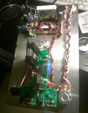

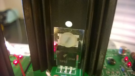

I got the kits few days ago and thought to do crack+speedball together. I finished all the soldering and put the tubes in. Turned on the crack and waited few seconds. They started glowing at the bottom. As soon as i went to grab my voltmeter to start the voltage check, I heard a pop and a spark on the left side. Immediately I turned it off. Visual inspection didn't reveal any damaged parts. So I turned it on again and did the voltage check. Everything checked fine except T1 and T7l both were around 160 V. I also noticed the LEDs on one of the small boards didn't light up properly. the one close to the MJE350 looked off and and the one next to was very dim. All other LEDs were bright. Turned it off, and tried to troubleshoot more. I reheated the parts on the small board and nothing changed. I did another voltage check but this time i noticed after say 30 seconds the LEDs began to fade. I was checking T9 and the voltage dropped from 100 to 30 V. Then I saw smoke coming out from the rear, I looked over and saw the long 270 ohm resistor smoking and glowing kinda red in the middle. I turned the amp off and have stopped proceeding. I checked for loose connections and all the joints looked firm with enough solder on them. What should I do now? :(

The first thing to do is to remove the Speedball and build the Crack stock, with the resistors.  This is absolutely mandatory before proceeding with the rest of the installation.
From what you have mentioned, I'd imagine that the TIP50 transistors aren't installed properly, but it's not even worth looking at that until you know that you have a stock, functional Crack.

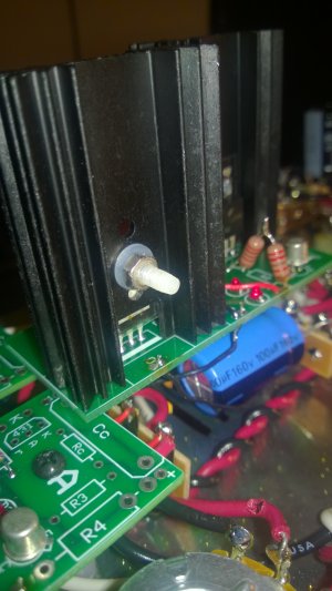

Did you install the mounting hardware as specified in the manual?  Recently, we have seen a reasonable number of folks leaving off the mica insulators or not using the shoulder washers.  Leaving out either part will cause the issues you describe.
I exactly assembled them the way the manual said.

I installed the small boards. One of them does not work. Only one of the LEDs lights up (very dim). T1 stays around 150 V.
    • Posts: 20262
Reply #7 on: December 08, 2014, 09:05:56 AM
Try swapping small boards, side to side, to ensure that the board is defective.
Offline Codeine
    • Posts: 14
Reply #8 on: December 08, 2014, 09:09:46 AM
Yup I did that too. The defective board doesn't work on the other side (the other one works on either side and gives correct voltages at its terminals).
Offline Codeine
    • Posts: 14
Reply #9 on: December 08, 2014, 09:59:43 AM
quick update: I checked the diodes on the defective boards with the multimeter on diode mode. D1 wouldnt pass so I looked closer and found out that one of the leads was broken off. So i replaced the diode with one of the diodes from the big board. Now both small boards work and voltages settle to correct values. I just need to get a new diode. Any suggestion as to where to get a replacement diode?

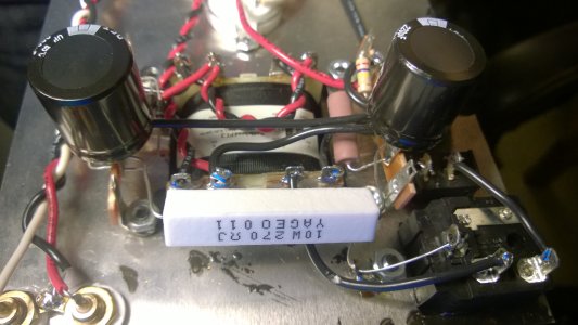

Thanks. I suspect that too. I'll be ordering some extra TIP50s just in case. I also noticed the 270ohm wirewound resistor that goes across the terminal strips gets extremely hot (the smoke was coming from this resistor). Can it be replaced by another resistor with higher power rating?
    • Posts: 20262
Reply #12 on: December 08, 2014, 01:21:15 PM
This resistor will get overly hot when there is a fault in the circuit, which would eventually blow the fuse.
That resistor and the other 270 Ohm resistor handle the same amount of current, but the one that goes across the power transformer is easier to notice.  In normal operation, that 5 Watt resistor sees about 1.3 Watts of power, which leaves a very large safety margin, and the operating temperature in that situation is well below any threshold of concern.
You can replace that resistor with a 10 Watt part, but the real solution is to fix the issue cooking it in the first place.

Well I triple checked everything. All the connections and joints seem to be in good shape (even reheated most of them). The voltage across the long 270 Ohm resistor is around 20 V, so it's dissipating around 1.5 Watts if i'm not mistaken. Also the 3k resistors get very hot too. I checked the bias points on the small boards they all make sense. I even reverted back to stock crack and still these resistors get very hot. I'm not sure what to make of this. I ordered the extra diodes today, so it'll take few days before I can proceed with the big board. As of now, I hear no noise or distortion in the sound. Maybe the tubes play a role in this? Can the 12AU7 cause this kind of a problem? the getter in my 12AU7 is a little tilted, is that normal? does it affect anything?
    • Posts: 20262
Reply #14 on: December 09, 2014, 08:56:24 AM
The resistors are supposed to get hot.  You've verified their dissipation by measuring the voltages.  If you'd like, you can hit them with an IR thermometer to look at their actual temperatures.  I believe the big resistors are rated to run at 150C, but we run them much cooler.  The tubes will also get hot, out of necessity, and this is nothing to be alarmed by.
